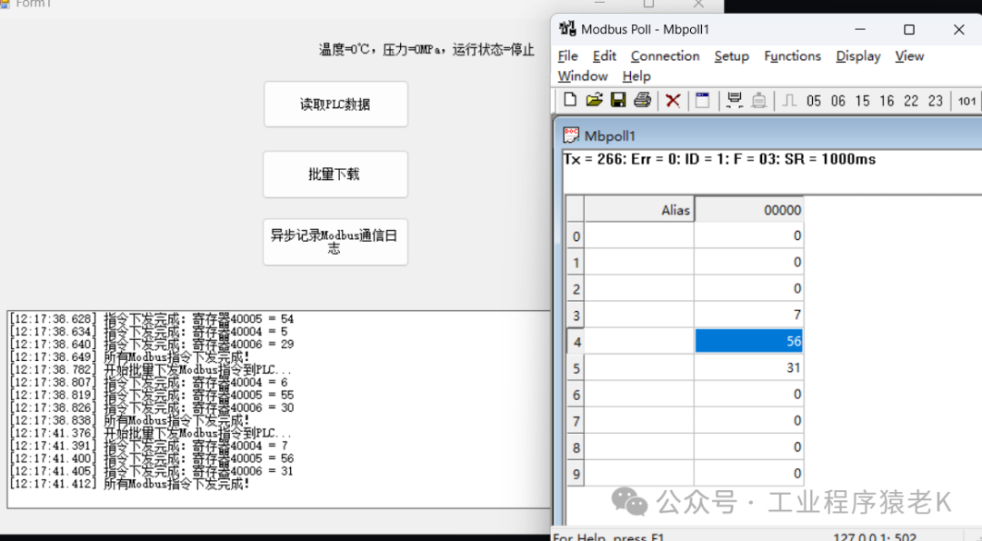

private async void btnReadPLC_Click(object sender, EventArgs e)
    btnReadPLC.Enabled = false; // 禁用按钮,防止重复点击(工控必做)
    Log($"开始连接PLC:IP={_plcIp}, 端口={_plcPort}");
    try
        // 封装Modbus读取逻辑为异步委托
        Func<Task<string>> readPlcLogic = async () =>
            // 异步执行Modbus通信(下面讲)
        // 异步执行,不阻塞UI
        string plcData = await readPlcLogic();
        lblPLCData.Text = plcData; // 更新PLC数据显示
        Log($"PLC数据读取完成:{plcData}");
    catch (Exception ex)
        // 异常捕获(工控中必须有,通信失败要提示)
        Log($"读取PLC失败:{ex.Message}");
        MessageBox.Show($"Modbus通信异常:{ex.Message}", "错误", MessageBoxButtons.OK, MessageBoxIcon.Error);
    finally
        btnReadPLC.Enabled = true; // 恢复按钮
关键说明:
  • • async void:仅用于UI 事件处理程序(如按钮点击),这是 C# 允许async void的唯一安全场景;
  • • btnReadPLC.Enabled = false:工控中必须做 —— 防止用户快速多次点击,导致同时建立多个 PLC 连接,引发端口占用 / 通信混乱;
  • • Func<Task<string>> readPlcLogic:把 Modbus 读取逻辑封装成异步委托(有返回值,返回 PLC 数据字符串),替代不能直接用的async Action。

private async void btnSendCommands_Click(object sender, EventArgs e)
    btnSendCommands.Enabled = false;
    Log("开始批量下发Modbus指令到PLC...");
    try
        // 模拟指令列表:(寄存器地址, 写入值)
        List<(int Address, ushort Value)> commands = new List<(int, ushort)>
            (40004, 1), // 启动指令
            (40005, 50),// 设定转速
            (40006, 25) // 设定温度
        // 封装单条指令写入逻辑为Action
        Action<(int Address, ushort Value)> sendCommandAction = (cmd) =>
            // 内部逻辑和读取类似:建立连接→写入寄存器→释放资源
            TcpClient tcpClient = null;
            IModbusMaster modbusMaster = null;
            try
                tcpClient = new TcpClient(_plcIp, _plcPort);
                modbusMaster = ModbusIpMaster.CreateIp(tcpClient);
                modbusMaster.Transport.WriteTimeout = 2000;
                int offset = cmd.Address - 40001;
                // 写入单个寄存器(工控中下发指令的核心API)
                modbusMaster.WriteSingleRegister(1, offset, cmd.Value);
                Log($"指令下发完成:寄存器{cmd.Address} = {cmd.Value}");
            finally
                modbusMaster?.Dispose();
                tcpClient?.Close();
                tcpClient?.Dispose();
        // 并行执行所有指令(提升效率)
        List<Task> tasks = new List<Task>();
        foreach (var cmd in commands)
            tasks.Add(Task.Run(() => sendCommandAction(cmd)));
        await Task.WhenAll(tasks);
        Log("所有Modbus指令下发完成!");
        Log($"下发指令失败:{ex.Message}");
    finally
        btnSendCommands.Enabled = true;
关键说明:
  1. 1. 指令封装:
    • • Action<(int Address, ushort Value)>:把单条写入指令封装成 Action,复用性强(比如不同设备的指令可以用同一个 Action);
    • • 工控中指令通常是 “地址 + 值” 的形式,比如 40004 写入 1 表示 “启动设备”,是 PLC 程序约定的逻辑。
  2. 2. **并行执行(Task.WhenAll)**:
    • • 批量下发指令时,并行执行比串行快数倍(比如 3 条指令串行要 3 秒,并行只要 1 秒);
    • • 适合工控中的 “广播指令”“批量参数配置” 场景,比如同时给多个寄存器设值。
  3. 3. WriteTimeout:写入超时必须设置,防止 PLC 忙时上位机无限等待。
