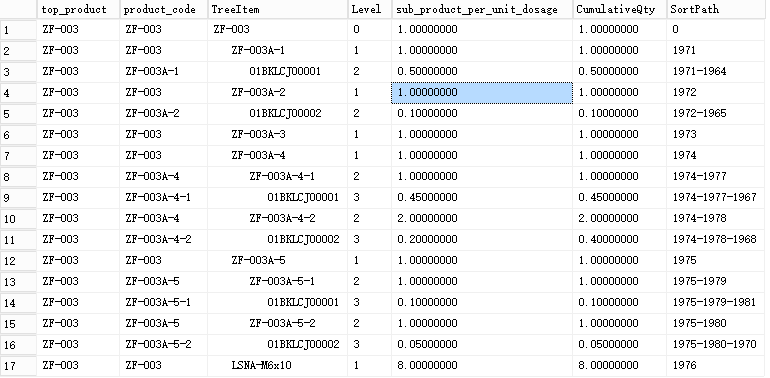

SELECT
top_product,
product_code,
    REPLICATE('   ', Level) + sub_product_code AS TreeItem,
    Level,
    sub_product_per_unit_dosage,
    CumulativeQty,
SortPath
FROM BOM_CTE
ORDER BY SortPath
OPTION (MAXRECURSION 100);
​展现的表格内容如下:
